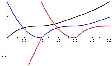

Example: $a=1$, $\phi(x)=x^2$.
For $x\in[0,1]$ $$ f(x)=\phi(0)+\int_{-1}^{x-1}t^2dt=x-x^2+\frac{x^3}{3}. $$ For $x\in[1,2]$ $$ f(x)=f(1)+\int_{0}^{x-1}\Bigl(t-t^2+\frac{t^3}{3}. \Bigr)dt=\frac{5}{4} - \frac{7 x}{3} + 2 x^2 - \frac{2 x^3}{3} + \frac{x^4}{12}. $$ For $x\in[2,3]$ $$ f(x)=f(2)+\int_{1}^{x-1}f(t)dt=\frac{x^5}{60}-\frac{x^4}{4}+\frac{3 x^3}{2}-\frac{13 x^2}{3}+\frac{19 x}{3}-\frac{197}{60}. $$ The graph shows the smoothness of $f$.
$f$ (black), $f'$ (red) and $f''$ (blue)]

  • I meant smooth at the boundaries ($0$, $a$, $2a$, ...). I tried $\phi(x) = x^2$to see what the result would be and $f$ is not differentiable at $x = 0, a, 2a, ...$ – jnm2 Sep 05 '11 at 18:37
