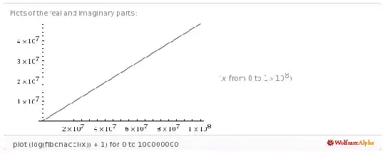

Here is a useful fact, for any positive number n, the number of digits of n in base 10 is given by:
$$\lfloor\log_{10}(n)\rfloor + 1$$
The number of digits of the Fibonacci sequence grows linearly, as can be shown in the graph.
plot of number of digits of Fibonacci numbers
