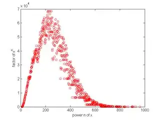

Given $y_{n}(x)=\left(\sum_{k=0}^{n-1} x^{2^k}\right)^{n}$. An example ($n=5$) may look like $$ y_5(x)={x^{80}}+5 x^{72}+5 x^{68}+5 x^{66}+5 x^{65}+10 x^{64}+20 x^{60}+20 x^{58}+20 x^{57}+20 x^{56}+20 x^{54}+20 x^{53}+40 x^{52}+20 x^{51}+40 x^{50}+30 x^{49}+35 x^{48}+60 x^{46}+60 x^{45}+60 x^{44}+60 x^{43}+80 x^{42}+50 x^{41}+61 x^{40}+60 x^{39}+100 x^{38}+90 x^{37}+85 x^{36}+70 x^{35}+95 x^{34}+65 x^{33}+75 x^{32}+{120 x^{31}}+120 x^{30}+100 x^{29}+110 x^{28}+100 x^{27}+90 x^{26}+90 x^{25}+100 x^{24}+100 x^{23}+90 x^{22}+70 x^{21}+66 x^{20}+70 x^{19}+55 x^{18}+65 x^{17}+75 x^{16}+60 x^{15}+50 x^{14}+50 x^{13}+40 x^{12}+30 x^{11}+31 x^{10}+25 x^{9}+15 x^{8}+10 x^{7}+5 x^{6}+x^{5} $$ If you plot exponents of addends of $y_n$ against prefactors, this looks (for $n=7$) like
$\hskip1.7in$enter image description here
Can this be described by a kind of Poisson distribution for general $n$?

    I'd consider instead $f(x)^n = \left(\sum_{k=0}^\infty x^{2^k-1}\right)^n = \sum_{m=0}^\infty a_m(n) x^m$ for $|x| < 1$ ? the central limit theorem should tell us that the coefficients $\frac{a_m(n)}{n}$ will tend to the normal distribution – reuns Mar 11 '16 at 06:33
    Are you sure your plot is for $n=7$ and not $n=8$? The average degree should be $2^n-1$ which is only $127$ for $n=7$ and $255$ for $n=8$ matching the plot. – A.S. Mar 11 '16 at 06:41
    Probabilistically speaking, you have a multinomial $M\sim MN(n,\frac 1 n,\dots,\frac 1 n)$ dotted with $V=(2^0,\dots, 2^{n-1})$: $S_M=M\cdot V$. You get $\mu_M=2^n-1$ and can compute variance exactly.
    Approximate $S_M$ by $S_B=\sum_{i=0}^{n-1} 2^{i}B(n,\frac 1 n)$ or go even further to get $S_P=\sum_{i=0}^{n-1} 2^{i}Pois(1)$. All cumulants of a Poisson are $1$, hence cumulants of $S_P$ are $$\kappa_k=\frac {2^{kn}-1}{2^k-1}$$ yielding variance $\kappa_2\approx \frac{4^n}3$ and $\kappa_{3}\approx\frac {8^n}7$. Quality of approximation of $S_M$ by $S_P$ deteriorate for higher cumulants.
    – A.S. Mar 11 '16 at 07:46
    The above yields asymptotic skew of $\frac {3^{3/2}}{7}\approx 0.74$ – A.S. Mar 11 '16 at 07:51
  • @A.S. thanks for your contribution. To be honest, I can't find the plot again, so it could be the one for $n=8$... – draks ... Mar 14 '16 at 19:28
