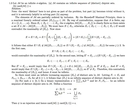

I found a very interesting answer to the question using Hausdorff Maximal Principle here in page 2. Let me take a screenshot for now. I will come back and latexify this when I have the time. enter image description here
