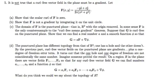

I tried to prove this problem using the Helmholtz decomposition theorem, but it seems the two are entirely contradictory--thus leaving me with empty hands. Does anyone know how to proceed?
problem
Thanks
Moehringer
Willie Wong
  • 75,276
    it is locally, but you are asked about cohomology. Anyway, see http://math.stackexchange.com/questions/81405/anti-curl-operator – Will Jagy Dec 12 '13 at 02:14
  • @moehringer : I don't know anything about the Helmholtz decomposition theorem, but how far did you get? Did you do (a) and (b)? How far did you get on (c) and (d)? – Stefan Smith Dec 12 '13 at 02:17
    I see, http://en.wikipedia.org/wiki/Helmholtz_decomposition which says nothing more here than the Poincare Lemma, that is there is a solution in a small disk around any point, or ball in three dimensions. http://en.wikipedia.org/wiki/De_Rham_cohomology – Will Jagy Dec 12 '13 at 03:06
    Saying that $F$ is a vector field "in the plane" is a bit misleading. It is, as noted in (c), a vector field on the punctured plane. On a simply connected domain, a curl-free vector field is a gradient. – ronno Dec 18 '13 at 09:55
  • The curl of your vector field F is the Dirac delta measure on the origin, i.e. it's everywhere zero except at the origin, and it integrates to 1. – Jules Jan 11 '18 at 13:43
