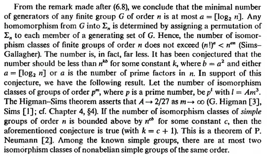

Interesting but very difficult question; sadly I don't think that we will see a definite answer to this question. I think it is clear, considering the complexity of the problem, that we cannot hope for a simple formula for general $n$. (In case you don't believe this, a problem which is rather easier than this one: there is an explicit expression (due to Rademacher) for the partition number.). The best I can do is quote the following (taken from Suzuki: Group theory, vol. I., Grundlehren d. math. Wiss., chap. I, §7.): enter image description here
Instead of repeating what he says let me remark that that $\Sigma_n$ denotes the symmetric group on $n$ letters. It should be said that this book is rather advanced, and it seems that even though it is about 30 years old you cannot hope for more than some (crude) estimates. (I include the references which he gives there upon request.)
