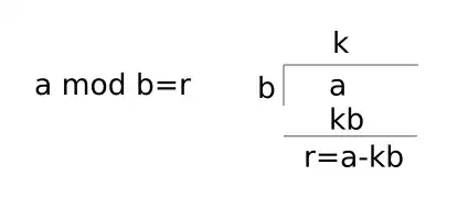

Lemma : If $c$ divides both $a$ and $b$ then $c$ divides $gcd(a,b)$, i.e.,
$c|a$ and $c|b\implies c|gcd(a,b)$
We have to prove $gcd(a,b)=gcd(a,a \mod b )$
img where $k>0$ and $k\in \mathbb{Z}_+$.
  • Part 1
Let $d_1=gcd(a,b)$ then $d_1|a$ and $d_1|b$ $$ \implies a=t_1d_1\quad\&\quad b=t_2d_1\\ \implies a=t_1d_1\quad\&\quad kb=kt_2d_1=t_3d_1\\ \implies r=a\mod b=a-kb=(t_1-t_3)d_1=t_4d_1\\ i.e., d_1|b\quad\&\quad d_1|a\mod b $$ Using Lemma we can conclude that $d_1|gcd(b,a\mod b)=d_2$
  • Part 2
$d_2=gcd(b,a\mod b)\implies d_2|b\quad\&\quad d_2|a\mod b$ $$ \implies d_2|b\quad\&\quad d_2|a-kb\\ \implies d_2|kb\quad\&\quad d_2|a-kb\\ \implies d_2|kb+(a-kb)\implies d_2|a\\ \text{Using Lemma implies, }d_2|b\quad\&\quad d_2|a \implies d_2|gcd(a,b)=d_1 $$
Therefore, $gcd(b,a\mod b)|gcd(a,b)$ and $gcd(a,b)|gcd(b,a\mod b)$ implies $gcd(a,b)=gcd(b,a\mod b)$
