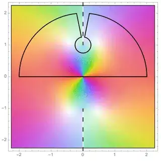

Let $f(z)$ be the integrand, swapping $y$ for the complex variable $z$, and let $\Gamma$ denote an indented, semicircular contour. We make a cut along the imaginary axis at $[i,i\infty)$ (as well as along $[-i,-i\infty)$, but that's not totally relevant here). $\Gamma$ is composed of a line segment of length $2R$; a large, broken semicircle centered at the origin of radius $R$; a smaller, broken circle centered at $+i$ of radius $\varepsilon$; and two opposing line segments joining the arcs. Here's a rough sketch:
I claim without proof that the integrals along the circular contours vanish as $R\to\infty$ and as $\varepsilon\to0$.
