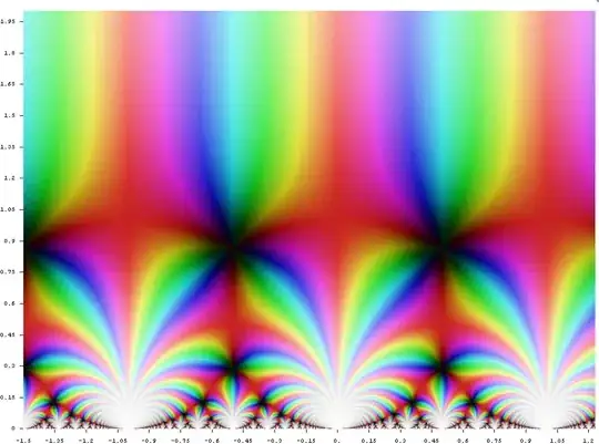

After examining this picture from Wikipedia: enter image description here
I've speculated that $\lambda(\exp(2\pi i/6))=\exp(2 \pi i/6),\lambda(\exp(2 \pi i/3))=\exp(- 2 \pi i/6)$. (However, I have no idea how to prove it)
