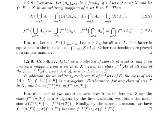

While reading Bogachev's Measure Theory Vol I, I've stumbled upon a bit I don't follow: I don't understand the reasoning behind the very last sentence in the proof of Corollary 1.2.9 (see image below); namely, I don't see what follows from the second assertion nor do I understand the implication.
Would greatly appreciate some clarification!
Here's a link to a screencap of the relevant bitsCorollary 1.2.9
Thanks in advance.

Consider the $\sigma$ algebra $\sigma(f^{-1}(\mathcal{F}))$. By the second assertion
$$\mathcal G:=\{ A \subset X | f^{-1}(A) \in \sigma(f^{-1}(\mathcal{F})) \}$$ is a $\sigma$-algebra.
As $\mathcal{F} \subset \mathcal G$ and $\mathcal G$ is a $\sigma$-algebra, you have
$$\sigma(\mathcal{F}) \subset \mathcal G \,.$$
Thus by the definition of $\mathcal G$ we have
$$f^{-1}(\sigma(\mathcal{F})) \subset \sigma(f^{-1}(\mathcal{F})) $$
