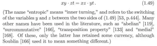

Furthermore, from page 27 of An Introduction to Quasigroups and Their Representations by J.D.H. Smith:
screenshot
and, from the bibliography of this latter:
  • [53] is I.M.H. Etherington Non-Associative Arithmetics, 1949.
  • [119] is D.C. Murdoch Structure of abelian quasigroups, 1941.
  • [133] is J.H. Przytycki, P. Traczyk Conway algebras and skein equivalences of links, 1987.
  • [166] is J.-P. Soublin, Étude algébrique de la notion de moyenne, 1971.
  • [168] is S.K. Stein On the foundations of quasigroups, 1957.
