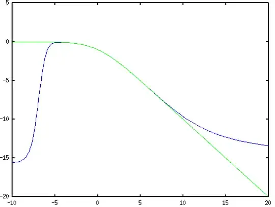

Question: Is $$-x/(1-\exp(-x))=\lim_{n\rightarrow \infty} \left (\sum_{p_n(\lambda)=0}\frac{1}{1-\lambda x}-n+1 \right)$$ at least for $|x|<1$? Here is a plot for $-x/(1-\exp(-x))$ (green) and $\sum_\lambda \frac{1}{1-\lambda x}-n+1$ (blue) for $n=16$
good fit for $|x|<1$
and the octave code to generate it

The desired limit formula holds for all real $x$, and even for all complex $x$ other than nonzero integer multiples of $2\pi i$.
The key is to write $\sum_{p_n(\lambda)=0} 1/(1-\lambda x)$ in terms of a logarithmic derivative.
We may assume $x\neq 0$. Define $$ q_n(x) = \frac{x^{n-1}}{n!} p_n(1/x) = \sum_{m=1}^{n-1} \frac{y^m}{m!} $$ (with $m=n-k$), so that $$ q_n(x) = x \prod_\lambda (1-\lambda x), $$ the product ranging over the $n-2$ zeros of $p_n$ (with multiplicity if necessary). Therefore $$ -x\frac{q'_n(x)}{q_n(x)} = -x \; \Bigl(\frac1x - \sum_\lambda \frac\lambda{1-\lambda x} \Bigr) = -1 + \sum_\lambda \frac{\lambda x}{1-\lambda x}. $$ Each summand $\frac{\lambda x}{1-\lambda x}$ can be written as $\frac1{1-\lambda x} - 1$, so the right-hand side is $$ \sum_\lambda \frac1{1-\lambda x} - n + 1. $$ On the left-hand side, $q'_n(x)$ is a partial sum of the power series for $e^x$, and $q_n(x)$ is a partial sum of the power series for $e^x-1$. These power series converge for all $x \in {\mathbb C}$. Therefore, as long as $e^x - 1 \neq 0$, $$ -x \frac{q'_n(x)}{q_n(x)} \rightarrow -x \frac{e^x}{e^x-1} = \frac{-x}{1-e^{-x}}, $$ and the proof is complete.
