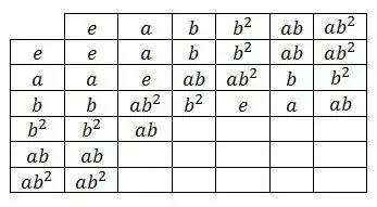

We already know that one of two proper normal subgroups of $S_4$ is the Klein $4-$group $$V={(1), (1 2)(3 4), (1 3)(2 4), (1 4)(2 3)}$$ with quotient $S_3=S_4/V$ of order $6$. Knowing the following presentation of $S_3$, we can make the Cayley table of it easily:
$$S_3=\langle a,b\mid a^2=b^3=(ab)^2=1\rangle$$
Since $(ab)^2=1$ so we get $abab=1$ and so $$aba=b^2,~~bab=a$$ Now can make th Operation table of $S_3$ and simplify some relations in it:
I left some boxex for you to fill. Also, considering a computational way, by using GAP, we have:
