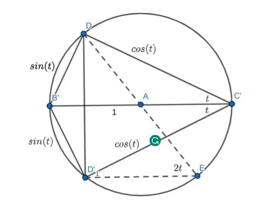

A visual proof by applying Ptolemy's Theorem.
Imagine the circle as shown with diameter $1$. Then, by applying Ptolemy's theorem on the cyclic quadrilateral $B'DC'D'$ we have $B'D \times C'D' + C'D \times B'D' = B'C' + DD'$, equaling $2 \sin(t)\cos(t) = \sin(2t)$. To see why $D'D = \sin(2t)$, notice the triangle $D'DE$.
- 51

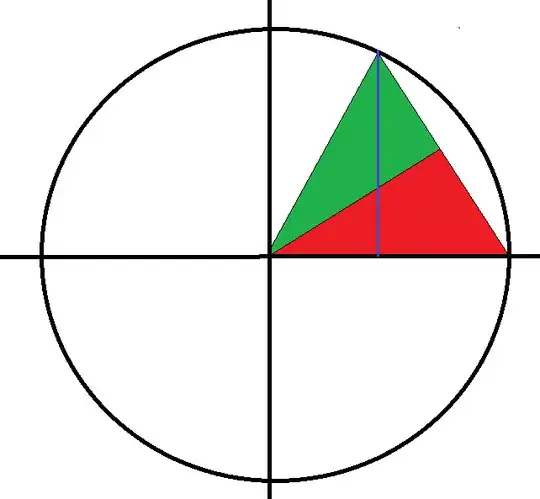

Lets suppose the larger triangle is an isoceles triangle with its vertex at the origin. The legs are of lenght 1 (and it has been inscribed in the unit circle). It has been bisected into two congruent right triangles.
We will say that the larger triangle has a vertex angle of $2t$, and each of the smaller triangles have a measure t at that vertex.
The lenght of the segment that bisects the isosceles triangle (the border between red and green) has lenght $\cos t$ each of the right triangles have legs of $\sin t$ opposite the angle.
The area of the each of these is then $\frac 12 \sin t\cos t$ and together their area is $\sin t\cos t$
The lenght of the blue line is $\sin 2t$ Using that as the height at $1$ as the base gives the area of the large tringle as $\frac 12 \sin 2t$
We have now calculated the same area by two different methods and they must be equal.
$\frac 12 \sin 2t = \sin t\cos t$
The area of the large triangle is $\frac 12 \sin t$
- 12,247
