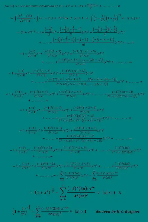

For $|x|\leq 1$ use binomial expansion of $(1+x)^n=1+nx+\frac{n(n-1)}{2!}x^2+\dots\infty$
\begin{array} $\Rightarrow\displaystyle\int\frac{(x^2-1)\mathop{}\!\mathrm{d}x}{\sqrt{x^4+1}}= \begin{cases} \displaystyle\int(x^2-1)(1+x^4)^{-1/2}\mathop{}\!\mathrm{d}x,& \text{if}\ |x|\leq1 \\ \displaystyle\int\left(1-\frac 1{x^2}\right)\left(1+\frac 1{x^4}\right)^{-1/2}\mathop{}\!\mathrm{d}x,& \text{if}\ |x|\geq1 \\ \end{cases} \end{array}
\begin{align} \Rightarrow(1+x^4)^{-1/2} & = 1+\sum_{n=1}^\infty\frac{\left(-\dfrac12\right)\left(-\dfrac12-1\right)\left(-\dfrac12-2\right)\dots\left(-\dfrac12-(n-1)\right)}{n!}(x^4)^n \\ & = 1+\sum_{n=1}^\infty\frac{(-1)^n\big(1\times3\times5\dots(2n-1)\big)}{2^n\times n!}(x^4)^n \\ & = 1+\sum_{n=1}^\infty\frac{(-1)^n\big(1\times2\times3\times4\times5\dots(2n-2)\times(2n-1)\big)}{2^n\times n!\big(2\times4\times6\times8\dots(2n-2)\big)}(x^4)^n \\ & = 1+\sum_{n=1}^\infty\frac{(-1)^n(2n-1)!}{2^n\times n!(2^{n-1}(n-1)!)}(x^4)^n \\ & = 1+\sum_{n=1}^\infty\frac{(-1)^n(2n)(2n-1)!}{2^n\times n!(2\times2^{n-1})\big(n\times(n-1)!\big)}(x^4)^n \\ & = \sum_{n=0}^\infty\frac{(-1)^n(2n)!}{2^n\times n!(2^n)(n!)}(x^4)^n \\ & = \sum_{n=0}^\infty\frac{(-1)^n(2n)!}{2^{2n}(n!)^2}(x^4)^n \\ & = \sum_{n=0}^\infty\frac{(-1)^n(2n)!x^{4n}}{4^n(n!)^2}. \end{align}
\begin{align} \therefore(1+x^4)^{-1/2}&=\sum_{n=0}^\infty\frac{(-1)^n(2n)!x^{4n}}{4^n(n!)^2},&&\forall|x|\leq1; \\ \left(1+\frac1{x^4}\right)^{-1/2}&=\sum_{n=0}^\infty\frac{(-1)^n(2n)!x^{4n}}{4^n(n!)^2},&&\forall|x|\geq1. \end{align}
Original answer picture:
Binomial expansion of the expression to used in the respective integrals
Use binomial expansions of the expressions in respective integrals as given in the previous solution of the problem.
