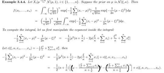

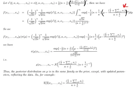

UPDATE: Background - full question from my lecture
Its actually a probability question, but the integration part in question is marked with a red arrow ...

For starters, let us notice that our only integration variable is $\mu$ , and that all other symbols which appear there are independent of it, behaving like simple constants as far as the actual integration process is concerned. Thus our integral becomes $$\int_{-\infty}^\infty e^{-a(x-b)^2}dx=\int_{-\infty}^\infty e^{-at^2}dt=\frac1{\sqrt a}\int_{-\infty}^\infty e^{-u^2}du=\sqrt\frac\pi{a}$$ where a is $\frac{n+\frac1k}2$ , since we know that the value of the Gaussian integral is $\int_{-\infty}^\infty e^{-u^2}du=\sqrt\pi$.

  • Ok I got it: using substitution $u=\sqrt{a}t$ – Jiew Meng Nov 15 '13 at 00:08
