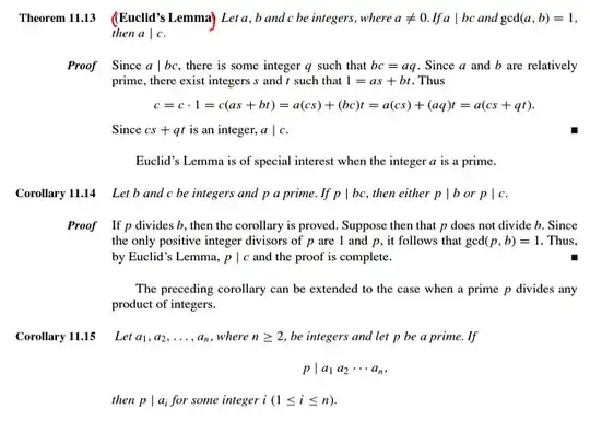

Euclid's Lemma (see snapshot at end) is given in a chapter of the textbook my class has not yet reached, so we may not assume this without proving it first. (But we may assume everything up to and including chapter 8 in this textbook(table of contents)). So I am trying to find a short proof for (1) $$p\mid ab\implies p\mid a \text{ or } p\mid b$$ that does not require Euclid's or Bezout's lemmas, if possible. If it is possible to show (1), then it seems proving $p | n^2 \Rightarrow p | n$ should be straightforward.

Euclid's Lemma
EuclidLemma
