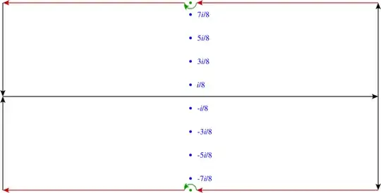

Let's compute $\newcommand{\sech}{\mathrm{sech}}(-1)^n\int_{-\infty}^\infty\frac{\sech(n\pi x)}{x^2+1}\mathrm{d}x$ .
$\sech(n\pi x)$ has simple poles at $x=\frac{2k+1}{2n}i$, with residue $\frac{(-1)^k}{n\pi i}$ .
$\frac1{x^2+1}$ has simple poles at $x=\pm i$, with residue $\frac1{\pm2i}$ .
$\hspace{8mm}$contours and poles
Note that the integrals along the vertical segments vanish at $\infty$.
The integral along the upper rectangular contour is the integral in question: $\int_{-\infty}^\infty\frac{\sech(n\pi x)}{x^2+1}\mathrm{d}x$, minus the Principal Value integral along the red path: $\color{#C00000}{\int_{-\infty+i}^{\infty+i}\frac{\sech(n\pi x)}{x^2+1}\mathrm{d}x}$, minus $\pi i$ times the residue at $x=i$: $\color{#00A000}{\pi i\times(-1)^{n}\frac1{2i}=(-1)^{n}\frac\pi2}$. This is also $2\pi i$ times the sum of the residues inside the contour: $\color{#0000FF}{\sum\limits_{k=0}^{n-1}\frac{(-1)^k}{n}\raise{6pt}{\frac2{1-\left(\frac{2k+1}{2n}\right)^2}}}$ .
The integral along the upper rectangular contour is the integral in question: $\int_{-\infty}^\infty\frac{\sech(n\pi x)}{x^2+1}\mathrm{d}x$, minus the Principal Value integral along the red path: $\color{#C00000}{\int_{-\infty-i}^{\infty-i}\frac{\sech(n\pi x)}{1+x^2}\mathrm{d}x}$, plus $\pi i$ times the residue at $x=-i$: $\color{#00A000}{\pi i\times-(-1)^{n}\frac1{2i}=-(-1)^{n}\frac\pi2}$. This is also $-2\pi i$ times the sum of the residues inside the contour: $\color{#0000FF}{\sum\limits_{k=0}^{n-1}\frac{(-1)^k}{n}\raise{6pt}{\frac2{1-\left(\frac{2k+1}{2n}\right)^2}}}$ .
Putting these together gives $$ \begin{align} &\int_{-\infty}^\infty\frac{\sech(n\pi x)}{x^2+1}\mathrm{d}x\\ &=\frac12\left( \color{#C00000}{(-1)^n\int_{-\infty}^\infty\frac{\sech(n\pi x)}{x^2+2ix}\mathrm{d}x} +\color{#00A000}{(-1)^n\frac\pi2} +\color{#0000FF}{\sum_{k=0}^{n-1}\frac{(-1)^k}{n}\frac2{1-\left(\frac{2k+1}{2n}\right)^2}} \right)\\ &+\frac12\left( \color{#C00000}{(-1)^n\int_{-\infty}^\infty\frac{\sech(n\pi x)}{x^2-2ix}\mathrm{d}x} +\color{#00A000}{(-1)^n\frac\pi2} +\color{#0000FF}{\sum_{k=0}^{n-1}\frac{(-1)^k}{n}\frac2{1-\left(\frac{2k+1}{2n}\right)^2}} \right)\\ &=(-1)^n\int_{-\infty}^\infty\frac{\sech(n\pi x)}{x^2+4}\mathrm{d}x +(-1)^n\frac\pi2 +8n\sum_{k=0}^{n-1}\frac{(-1)^k}{(2n)^2-(2k+1)^2}\\ &=\small(-1)^n\left(\frac12\int_{-\infty}^\infty\frac{\sech(2n\pi x)}{x^2+1}\mathrm{d}x +\frac\pi2\right) +2\sum_{k=0}^{n-1}(-1)^k\left(\frac1{2n+2k+1}+\frac1{2n-2k-1}\right)\\ &=\small(-1)^n\left(\frac12\int_{-\infty}^\infty\frac{\sech(2n\pi x)}{x^2+1}\mathrm{d}x +\frac\pi2 -4\sum_{k=0}^{n-1}(-1)^k\frac1{2k+1}+2\sum_{k=0}^{2n-1}(-1)^k\frac1{2k+1}\right)\tag{1} \end{align} $$ Rearranging $(1)$ yields $$ \begin{align} &(-1)^n\int_{-\infty}^\infty\frac{\sech(n\pi x)}{x^2+1}\mathrm{d}x +4\sum_{k=0}^{n-1}(-1)^k\frac1{2k+1} -\pi\\ &=\frac12\left( \int_{-\infty}^\infty\frac{\sech(2n\pi x)}{x^2+1}\mathrm{d}x +4\sum_{k=0}^{2n-1}(-1)^k\frac1{2k+1} -\pi \right)\\[6pt] &\to0\tag{2} \end{align} $$ Therefore, $$ (-1)^n\int_{-\infty}^\infty\frac{\sech(n\pi x)}{x^2+1}\mathrm{d}x =\pi-4\sum_{k=0}^{n-1}(-1)^k\frac1{2k+1}\tag{3} $$ Now, applying $(3)$, with $n=4$, to the question: $$ \begin{align} \int_0^\infty\frac{\mathrm{d}x}{\left(e^{\pi x}+e^{-\pi x}\right)\left(16+x^2\right)} &=\frac14\int_{-\infty}^\infty\frac{\mathrm{sech}(\pi x)\,\mathrm{d}x}{16+x^2}\\ &=\frac1{16}\int_{-\infty}^\infty\frac{\mathrm{sech}(4\pi x)\,\mathrm{d}x}{1+x^2}\\ &=\frac\pi{16}-\frac14\left(1-\frac13+\frac15-\frac17\right)\\ &=\frac\pi{16}-\frac{19}{105}\tag{4} \end{align} $$

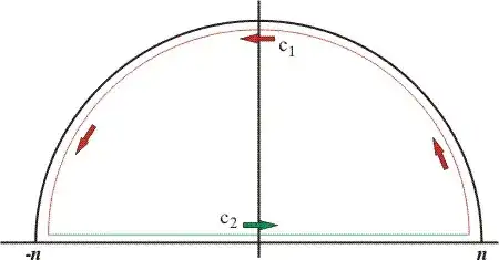

\begin{align*} I &= \int_0^\infty \frac{1}{\left(e^{\pi x} + e^{-\pi x}\right) \left(16 + x^2\right)} \, dx \\ &= \frac{1}{2} \int_{-\infty}^\infty \frac{1}{\left(e^{\pi x} + e^{-\pi x}\right) \left(16 + x^2\right)} \, dx \quad (\text{due to parity}). \end{align*}
Let the complex function be $$ f(z) = \frac{1}{\left(e^{\pi z} + e^{-\pi z}\right) \left(16 + z^2\right)}. $$ It is meromorphic and has simple poles in the upper half-plane at $$ z_n = i\left(n + \frac{1}{2}\right), \quad n = 0, 1, 2, \dots, $$ and at $z = 4i$, with the following residues: $$ \text{Res}(f(z), 4i) = \frac{-i}{16}, \quad \text{Res}\left(f(z), i\left(k + \frac{1}{2}\right)\right) = \frac{1}{2\pi i} \cdot \frac{(-1)^k}{16 - \left(k + \frac{1}{2}\right)^2}. $$
We consider the complex integral of $f(z)$ on the contour $C = C_1 + C_2$, where $C_1$ is the upper semicircle of radius $n$, avoiding the poles. For $n > 4$, we have $$ \left| 16 + z^2 \right| \geq \left| z^2 \right| - 16 = n^2 - 16 \quad \Rightarrow \quad \frac{1}{\left| 16 + z^2 \right|} \leq \frac{1}{n^2 - 16}. $$ Also, $$ e^{\pi z} + e^{-\pi z} = e^{\pi n \left( \cos \theta + i \sin \theta \right)} + e^{-\pi n \left( \cos \theta + i \sin \theta \right)} \Rightarrow \left| e^{\pi z} + e^{-\pi z} \right| = \sqrt{2} \sqrt{e^{2 \pi n \cos \theta} + e^{-2 \pi n \cos \theta}} \geq 2. $$ Thus, we get $$ \left| f(z) \right| \leq \frac{1}{2 \left(n^2 - 16\right)} \xrightarrow{n \to \infty} 0. $$ Hence, $\int_{C_1} f(z) \, dz = 0$ and $$ \int_C f(z) \, dz = \int_{C_2} f(z) \, dz = \int_{-\infty}^\infty \frac{1}{\left(e^{\pi x} + e^{-\pi x}\right) \left(16 + x^2\right)} \, dx. $$
Therefore, $$ I = \frac{1}{2} \cdot \int_C f(z) \, dz = \pi i \cdot \sum \text{Res}\left(f(z), \dots\right) = \pi i \cdot \left( \frac{-i}{16} + \frac{1}{2\pi i} \sum_{n=0}^\infty \frac{(-1)^k}{16 - \left(k + \frac{1}{2}\right)^2} \right). $$
Finally, we obtain $$ I = \frac{\pi}{16} - \frac{1}{2} \sum_{n=0}^\infty \frac{(-1)^k}{\left(k + \frac{1}{2}\right)^2 - 16}. $$ By simplifying the sum: \begin{align*} \sum_{k=0}^\infty \frac{(-1)^k}{\left(k + \frac{1}{2}\right)^2 - 16} &= \sum_{k=0}^\infty \frac{(-1)^k}{(k - 4 + \frac{1}{2})(k + 4 + \frac{1}{2})} \\ &= \frac{1}{8} \sum_{k=0}^\infty (-1)^k \left( \frac{1}{k - 4 + \frac{1}{2}} - \frac{1}{k + 4 + \frac{1}{2}} \right). \end{align*}
Taking the limit: \begin{align*} \lim_{N \to \infty} \left( \sum_{k=-4}^{N-4} \frac{(-1)^k}{k + \frac{1}{2}} - \sum_{k=4}^{N+4} \frac{(-1)^k}{k + \frac{1}{2}} \right) &= \sum_{k=-4}^3 \frac{(-1)^k}{k + \frac{1}{2}} - \lim_{N \to \infty} \left( \sum_{k=N-3}^{N+4} \frac{(-1)^k}{k + \frac{1}{2}} \right) \\ &= \sum_{k=-4}^3 \frac{(-1)^k}{k + \frac{1}{2}} = \frac{304}{105}. \end{align*}
Thus, $$ \int_0^\infty \frac{1}{\left(e^{\pi x} + e^{-\pi x}\right)\left(16 + x^2\right)} \, dx = \frac{\pi}{16} - \frac{19}{105}. $$ Image
