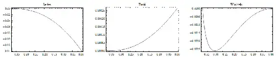

Here's a graphical side-by side comparison of three approximants over the interval $(-e^{-1},0)$. The plots are of functions of the form $f(z)-W(z)$, where $f(z)$ is one of the following: the first five terms of the branch point series, a $(3,2)$ Padé approximant constructed from the series,
$$W(z)\approx\frac{-1+\frac16 t+\frac{257}{720}t^2+\frac{13}{720}t^3}{1+\frac56 t+\frac{103}{720}t^2}, \qquad t=\sqrt{2ez+2}$$
and the Winitzki approximant:
- 76,540
