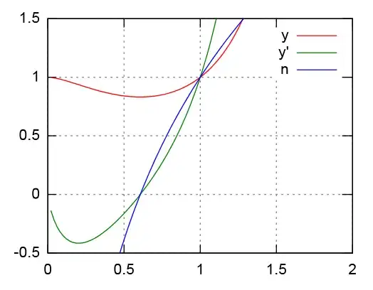

Using the übercool JavaScript port of Gnuplot at http://gnuplot.respawned.com/, where I paste
set terminal svg enhanced size 400,300
set output 'out.svg'
set grid
plot [0:2][-0.5:1.5] exp(x*x*log(x)) title "y", exp((x*x+1) * log(x)) \
* (2 * log(x) + 1) title "y'", 2 * log(x) + 1 title "n"
I get this nice graph:
If you read until here I thank you. For me it was my first post here and i am amazed about the expressive features (formulas, graphs) here.
