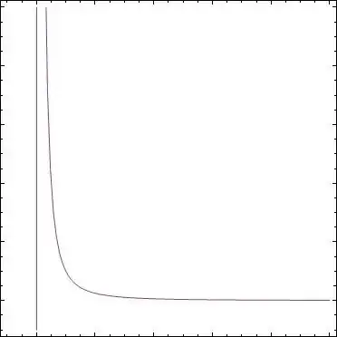

Notice that $$f''(x)>0$$ It means $f'(x)$ is increasing function, and then, the shape of function $f(x)$ is like this.(approximatlly)
so, you can notice that $$\lim_{x\rightarrow 0^+}f'(x)=-\infty$$
