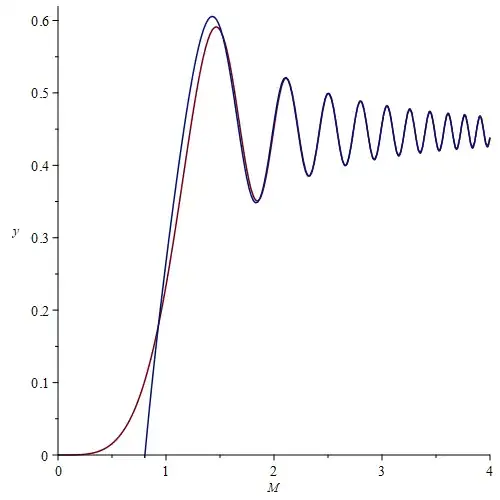

Figure 1. Graphs of $\color{#7f0000}{\int_0^M \sin (x^3) \,dx}$ (red) and the approximation $\color{#00007f}{\frac16 \Gamma\left(\frac13\right) - \frac1{3 M^2} \cos (M^3)}$ (blue):
