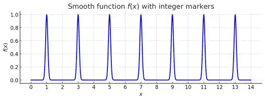

Let $N \in \mathbb{N}^\star$ and consider a function $f\colon \mathbb{R} \to [0,1]$ of class $C^1$, supported in $[0,2N]$, such that: $$ f(k) = \begin{cases} 0, & \text{if } k \in \{0,2,4,\dots,2N\}, \\ 1, & \text{if } k \in \{1,3,\dots,2N-1\}. \end{cases} $$

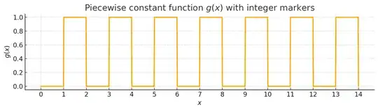

Now define a function $g\colon \mathbb{R} \to \mathbb{R}$ of bounded variation, also supported in $[0,2N]$, by $$ g(x) = \begin{cases} 0, & \text{if } x \in [2k,2k+1), \quad 0 \leq k < N, \\ 1, & \text{if } x \in [2k+1,2k+2), \quad 0 \leq k < N, \\ 0, & \text{otherwise}. \end{cases} $$
Both $f$ and $g$ are bounded, with $$ \|f\|_\infty = \|g\|_\infty = 1, $$ but the Riemann–Stieltjes integral satisfies $$ \int f \, dg = f(1) + f(3) + \dots + f(2N - 1) = N, $$ which clearly shows that the integral can exceed the product $\|f\|_\infty \cdot \|g\|_\infty$.

  • @Quertiopler i. $N$ is a positive integer. ii. $k$ is running between $0$ and $N.$ In the example $N=7$ and and both functions are $0$ outside $[0,14]$ – Daniel Smania Jun 19 '25 at 23:18
