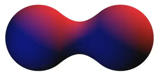

Edit: Adding an example.
For example, consider the shape formed at a level set of the sum of two metaballs (shown below). This shape is not convex, but it obeys the above generalized property. For any point on this surface, there is a line tangent to the surface that does not intersect the surface. (the line in question is the line through the point on the surface, which is perpendicular to the plane defined by the centers of the two balls and the point on the surface). The sum of three or more metaballs, or a difference of metaballs, does not necessarily obey this property, as those shapes can have indentations for which any tangent line must intersect the surface.
The sum of two metaballs, an hourglass-like shape with spherical ends
