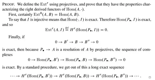

The key point is that, if $\mathcal{C}$ has enough injectives and enough projectives, then the two definitions of $\operatorname{Ext}^r(A,B)$ coincide. The following is the proof given in J. S. Milne's note Class Field Theory, Appendix II.A, Proposition A.$13$: Proof of coincidence
However, it seems that this proof also works if $\mathcal{C}$ has only enough injectives or only enough projectives, but not both.
So I was wondering if this condition is even necessary, namely:
Let $\mathcal{C}$ be an abelian category in general, and $A,B\in\mathcal{C}$. Given an injective resolution $B\to I^\bullet$ of $B$ and a projective resolution $P_\bullet\to A$ of $A$, do we have $$ H^r(\operatorname{Hom}(A,I^\bullet))\cong H^r(\operatorname{Hom}(P_\bullet,B)) $$ in the category of abelian groups?
