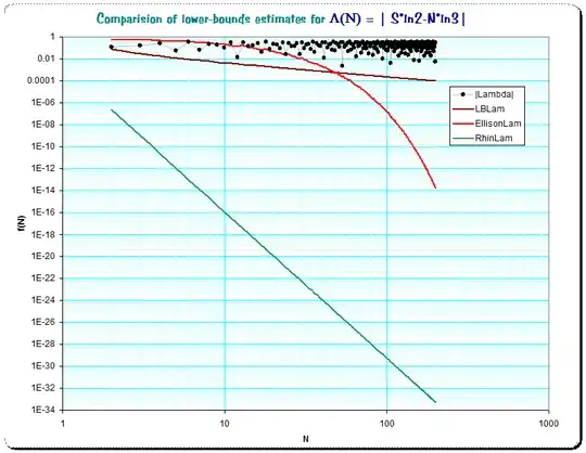

Another "extended comment". According to J. Simons in his article on "m-cycles in" the Collatz-problem 1 there is a lower bound for $\log(3^N/2^S)$ where $S=\lfloor N*\log_2(3) \rfloor$ by G. Rhin $$ \frac1{453 \cdot N^{13.3}} < |N \log 3 - S\log 2| \tag 1 $$ This is of course a very very weak lower bound, and should be quite useless for your problem.
But it may be interesting that I conjectured a much better lower bound as $$ \frac1{10 N \log N} < |N \log 3 - S\log 2| \tag 2$$ which I checked for the case when $S=\lceil N \cdot \log_2(3) \rceil$ instead and $2^S$ is the next larger power of $2$ over $3^N$ to be valid up to $N=10^{10^6}$ using the convergents of the continued fraction of $\log_2(3)$. The tightest seen approximation has been at $N \approx 10^{167.420644}$ and that case made me fix the constant to the value $10$. The curve of the trend pictured together with the empirical values makes a much much better impression of a realistic fit than the curve taken by the Rhin-lower bound. Another rather good approximating $N$ is at about $N \approx 10^{10853.9159281}$ - but in general the distance to the best approximated values grows slightly with the increasing $\log(N)$ - so there seems also room for improvement of the lower-bound function.
I have no proof for that lower bound holding for all $N$, but perhaps it gives some hint for your explorations (and finally might get improved by some cosmetic shaping).
In the picture below I draw the lower bounds given by G. Rhin (green colour) ,another one by Ellison (red), and that conjecture of mine (browne). See the much smoother adaption of the latter curve to the decreasing minimals of the empirical values(black points) :
Comparision of three lower bounds for Slog(2)-Nlog(3)
update
  • Explanation how to use my conjectured lower bound for your problem: From $$ \frac1{10 N \log N} < |N \log 3 - S\log 2| \tag 3 \\$$ we can step towards a formula better for estimate the lower bound for elements of your sequence depending on $N$: $$ \exp(\frac1{10 N \log N})< \frac{3^N}{2^S} \tag {3a}\\ \exp(\frac1{10 N \log N})-1< \frac{3^N}{2^S}-1 \\$$ $$ 2^S \cdot (\exp(\frac1{10 N \log N})-1)< 3^N - 2^S \tag {3b} $$ Removing small elements in the Taylorseries for $\exp(x)-1$ we can give an a bit weaker lower bound estimate: $$ \frac{ 2^S}{10 N \log N} < 3^N - 2^S \\ \tag 4 $$ It shows, that the lower bound increases roughly with $2^S/N/10$ and this lower bound exceeds your value $2465$ very soon (=with small $N$).

The rhs-value $2465$ in row of $N=8$ is overtaken by the $3144.69$ resp $3149.41$ values of resp. lhs in row of $N=13$ .
Because lhs is monotonuously increasing (from $N \ge 3$) and rhs is (by conjecture) always greater than lhs, there are no more numerical tests to be done.
