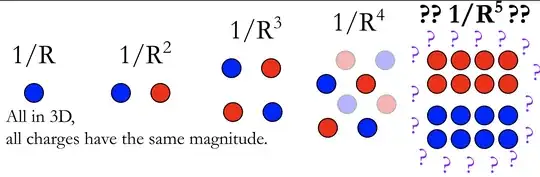

Short version of the problem: Given 8 +Q charges and 8 -Q charges in 3D, can I find an arrangement in which their potential has its leading non-zero term proportional to $1/r^5$?
Step by step description and motivation?
  1. Single +Q charge: In physics the potential of a single charge is $\propto Q/r$. A single charge +Q therefore has a potential whose leading term in the $1/r$ expansion is $1/r$.
  2. +Q and -Q: For two charges, one positive and one negative, of the same magnitude, the potential they produce has no $1/r$ component and its leading term is $1/r^2$. The arrangement that achieves this is a simple line where the charges sit at $(a,0,0)$ and $(-a,0,0)$.
  3. 2x +Q and 2x -Q: Continuing with the pattern, we can take the previous configuration of 2 charges, multiply them by -1, and move it by $2a$ in the so far unused orthogonal direction. After centering, we'd end up with a square whose vertices contain the charges, with $(-a,-a,0)$ and $(a,a,0)$ being +Q and $(-a,a,0)$ and $(a,-a,0)$ being -Q. Such a configuration has a potential whose leading term is $1/r^3$.
  4. 4x +Q and 4x -Q: Equivalently, we can build a cube with alternating charge signs in its vertices and the resulting potential is $\propto 1/r^4$.
The question now is: with 8 +Q charges, and 8 -Q, can I find a configuration that follows this trend, i.e. whose potential has a leading term of $1/r^5$? The procedure for generating the highly symmetric configuration that I used in the steps 1. - 4. relied on having new orthogonal dimensions in which to shift the copied and sign-flipped version of the previous configuration. Such a move can't be used anymore for $1/r^5$ in the 3D space since we already ran out of dimensions.
Could you find such a configuration and if not, could you prove that the charges can't be arranged in such a way in 3D?
Here's a visualization of the approach: Arranging 2^N charges in 3D
