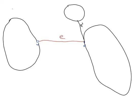

I would likely approach this using a proof by contradiction.
Here is my approach:
Let $G = (V, E)$ be a graph, and let $e \in E$ be a bridge. Assume that removing $e$ does not increase the number of connected components by exactly 1. This means one of the following two cases must hold:
  1. The number of components does not increase at all.
  2. The number of components increases by at least 2.
Case 1: The number of components does not increase.
By definition, a cut edge is an edge whose removal increases the number of connected components. However, in this case, removing $e$ does not change the number of components, which contradicts the assumption that $e$ is a cut edge. Thus, this case is impossible.
Case 2: The number of components increases by at least 2.
This would imply that removing $e$ separates $G$ into at least three connected components. However, since $e$ is an edge, it connects exactly two vertices in $G$, meaning that removing it can only separate one component into at most two new components. Therefore, this contradicts our assumption, and this case is also impossible since $u$ and $v$ have to be in different components.
Since both cases lead to contradictions, our assumption must be false. Therefore, removing a cut edge must increase the number of connected components by exactly 1. enter image description here
  • Your argument is simultaneously too detailed and not detailed enough. (It also reads like something an AI would generate, but my point is that it's not good.) The key point is "However, since $e$ is an edge, it connects exactly two vertices in $G$, meaning that removing it can only separate one component into at most two new components" and this needs more detail. Everything else in the answer is fluff. – Misha Lavrov Mar 13 '25 at 21:57
