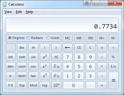

A photo of a primitive calculator caught in the wild:
