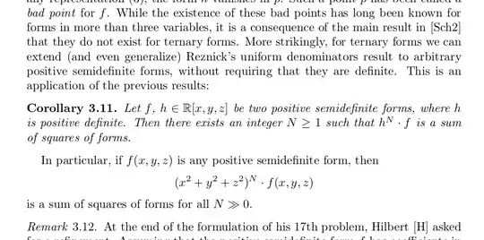

It is a result of Claus Scheiderer that there is a non-negative integer $N$ such that $$(x^2 + y^2 + z^2)^N ( x^4 (x-y)(x-z) + y^4(y-z)(y-x) + z^4(z-y)(z-x) )$$ is a sum of squares of real polynomials. Actually the result applies to any positive semidefinite polynomial in three real variables. He has a recent book. ADDED: The eBook is on sale, I actually managed to buy it!
So that is the QUESTION: show the original form is not SOS (or quote relevant software), give an expression for the multiplied expression as SOS, and tell me what software I can download.
Scheiderer's result
