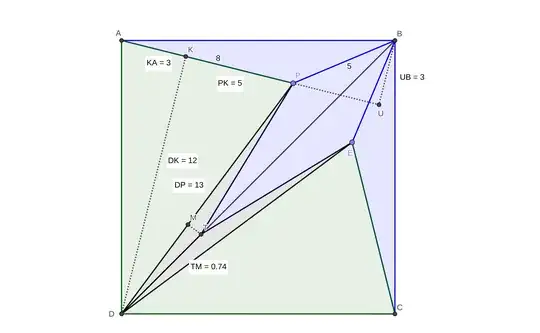

Hint:In the picture we have:
$\triangle APB=\triangle BPT=\triangle BTE=\triangle BCE$
$S_{APB}=\frac{8\times 3}2=12$
$\triangle APD=\triangle ECD$
$S_{APD}=\frac{8\times 12}2=48$
$S_{PDT}=S_{ETD}=\frac {0.74\times 13}2=4.81$
$S_{ABCD}=4\times12+ 2\times 48+2\times 4.63=153.26$
You can also do this:
$S_{ABCD}=AK^2+KD^2=3^2+12^2=153$
Update: we have right angled triangle BPU . BP=5, suppose BU and PU must have integer magnitude. The only possible numbers are $RU=3$ and $PU=4$ , in this case we have:
$AU=8+4=12$
$BU=3$
which gives:
$S_{ABCD}=AB^2=12^2+3^2=153$
Here is a link https://www.geogebra.org/classic
To see the picture click on recover.
sirous
  • 12,694
  • Accurate drawing isn't a proof (but I can see why an Engineer might consider it so). Furthermore, with this lengths, we can calculate (EG via cosine rule) $\angle ABP \neq \frac{90^\circ}{4}$, so you actually don't have an accurate drawing. (And that would explain how you arrived at a contradictory result for $ S_{ABCD}$) – Calvin Lin Mar 04 '25 at 00:36
