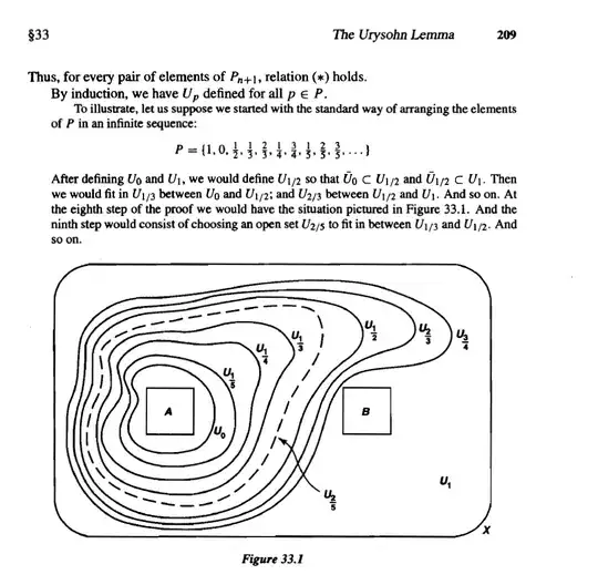

This a question from Munkres' Topology. I show you the whole context of the question below. enter image description here enter image description here
