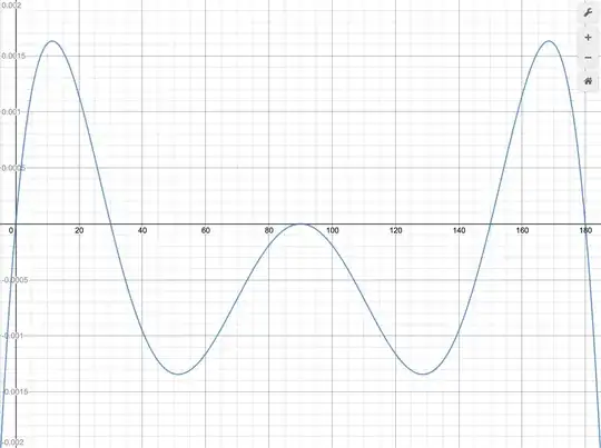

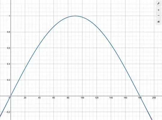

Bhaskara's approximation (Wikipedia) gives an approximation for $\sin x^\circ$ with less than $0.0016$ error for $0\leq x \leq 180$.
$$\sin x^\circ \approx \frac{4 x (180-x)}{40500 - x(180-x)}$$
The red curve is the approximation, barely seen:
Here's the difference between the formula and the sin function (maximum at x=11.544):
