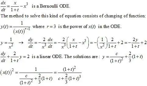

This is a Bernoulli ODE. Method of solving : http://mathworld.wolfram.com/BernoulliDifferentialEquation.html
