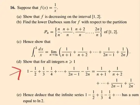

The original question:
Show that $\forall \, n\in \mathbb{Z}, n\geq 1$ the equation below holds
$$\begin{align} 1-\frac12 + \frac13 - \frac14 + \cdots + \frac{1}{2n-1} - \frac{1}{2n} =& \frac{1}{n+1} + \frac{1}{n+2} \\ & +\cdots + \frac{1}{2n-1} + \frac{1}{2n} \end{align}$$
In case further details are needed, here's the screenshot of the whole question. I took the question from How to Integrate It regarding Darboux Sum.
When I saw the word integers, my mind was sent to Mathematical Induction. However, I noticed that they are series and I doubt it would be helpful since if I plug in $n=1$ as an initiation of mathematical induction, it would fail at the term $\dfrac{1}{2n-2}$. So perhaps the writer of the book wants me to prove with something else? How?
I also noticed that the term on the left is an alternating Harmonic Series which originally I believe I could rewrite them as follows:
$$\lim_{n \to \infty}\sum_{k=1}^{2n} \frac{(-1)^{k+1}}{k} = \lim_{n \to \infty}\sum_{k=1}^{n} \frac{1}{n+k}$$
I was in doubt whether include the limit sign as $n$ approaches to infinity or not since from the question (c) the author told me so. Any help would be appreciated. Thank you.

You can use induction. The base case, for $n=1$ is $1-\frac 12=\frac 12$, which is true. Now assume it is true up to $k$. For $n=k+1$ we have $$1-\frac 12 + \frac 13 - \frac 14 \ldots +\frac 1{2k+1}-\frac 1{2k+2}=\\ \frac 1{k+1}+\frac 1{k+2}+\ldots \frac 1{2k}+\frac 1{2k+1}-\frac 1{2k+2}\\ =\frac 1{k+2}+\frac 1{k+3}+\ldots \frac 1{2k+1}+\frac 1{2k+2}$$ where in the first $=$ we plugged in the induction assumption and in the second we used $\frac 1{k+1}-\frac 1{2k+2}=\frac 1{2k+2}$
