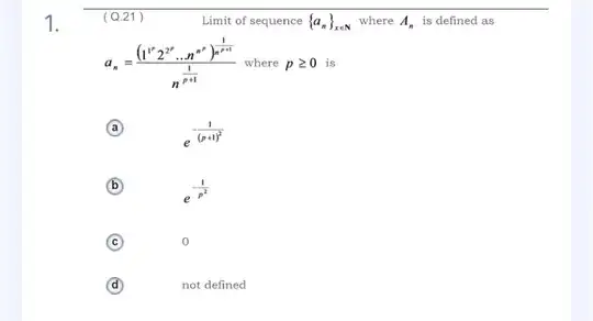

Limit of the sequence $\{ a_n \} $ where $a_n$ is defined as
$ a_n= \frac { \big( \Pi _{i=1}^ n i^{i^p}\big)^{\frac 1{n^{p+1} }}} {n^{\frac 1{p+1} }}$ where $p\ge 0$ is
(a) $ e^{ -\frac 1{(p+1)^2} } $
(b) $e^{-\frac 1{p^2} }$
(c) $0$
(d) Not defined.
