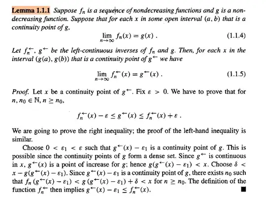

In the book Extreme value theory: an introduction, there's the following lemma.
Suppose $f_n$ is a sequence of non-decreasing functions and $g$ is a non-decreasing function. Suppose that for each $x$ in open interval $(a,b)$ that is a continuity point of $g$,
$$\lim_{n \to \infty} f_n(x) = g(x)$$.
Let $f_n^{\leftarrow}$ and $g^{\leftarrow}$ be the left-continuous inverse of $f_n$ and $g$. Then for each $x$ in the interval $(g(a), g(b))$ that is a continuity point of $g^{\leftarrow}$, we have
$$\lim_{n \to \infty} f_n^{\leftarrow}(x) = g^{\leftarrow}(x)$$.
