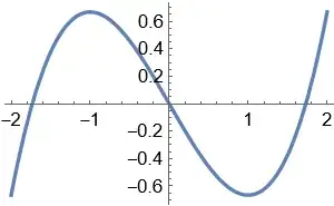

The potential $$V(s)= g \ (\frac{s^3}{3}-s)$$ has two extrema.
Cubic Potential
So there are three classes of orbits
  1. High energy $U \gt \frac{2}{3}$, impact from left, repulsion somrwhere at $ s>0$ for $s'=0$
  2. energy less maximum, the same but repulsion left of the maximum
  3. energy between local minimum and maximum, oscillation inside the pot

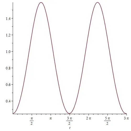

Maple also helps with initial condition $s(0)=s_0$:
$$s(t)=-\frac{6}{g}\cdot \wp \left(t+\tau, \frac{g^2}{3}, -\frac{g^{3} s_{0} \left(s_{0}^{2}-3\right)}{54} \right)$$
with $\tau=\mathit{RootOf}\left(s_{0}\cdot g+6\cdot \wp\! \left(\tau,\frac{g^{2}}{3},-\frac{g^{3} s_{0} \left(s_{0}^{2}-3\right)}{54}\right)=0, \tau\right)$
Example for $s_0=\frac{1}{4}, g=1$:
Solution for $\tau$: $$\{\tau \to \fbox{$(2.3403\, +2.58906 i)+4.6806 c_1+(0.\, +5.17813 i) c_2\text{ if }(c_1|c_2)\in \mathbb{Z}$}\}$$
Any $\tau$ value may be chosen.
Plot $s(t), g=1$:
ODE solution
Hint: $\wp(z,g_2,g_3)$ is the Weierstrass P function
