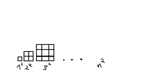

n squares
I included a poorly drawn picture to make myself a bit more clear. So we have $n$ squares, the first contains a single cell, the next then $2^2$ and so on till $n^2$ cells. If we add the cells in each square separately we get the number $1+2^2+3^2+\ldots+n^2$. If we change the way we count to adding the cells at each level we get:
  1. $1+2+\ldots+n$ on the first level
  2. $2+3+\ldots+n$ on the second level
  3. $3+4+\ldots+n$ on the third level
and so on, I hope you get the idea. The number on the first level is exactly $1+2+\ldots+n=\binom{n+1}{2}$ and on the $i$-th level it is $\binom{n+1}{2}-\binom{i}{2}$. Adding this up gives
\begin{align} \binom{n+1}{2}+\sum\limits_{i=2}^n(\binom{n+1}{2}-\binom{i}{2})&=\binom{n+1}{2}+(n-1)\binom{n+1}{2}-\sum\limits_{i=2}^n\binom{i}{2}\\ &=\binom{n+1}{2}+(n-1)\binom{n+1}{2}-\binom{n+1}{3}\\ &=\binom{n+1}{2}+3\binom{n+1}{3}-\binom{n+1}{3}\\ &=\binom{n+1}{2}+2\binom{n+1}{3}. \end{align}
Don't know whether it is what you were looking for tho, as it uses facts about binomial coefficients.
