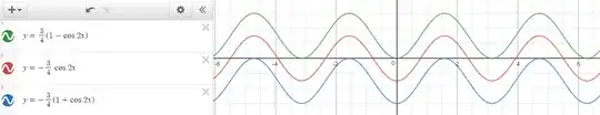

Actually, we are to find the antiderivative of the given function, and all the functions you have found out to be potential answers are equally correct because any of them is just a constant shifted version of another. The 3 answers plotted And these are not the only candidate to be the answers, we can find infinitely many more. When we differentiate all the results you have found out, we only get $3sinxcosx $ . And this is why when we try to find out the antiderivative of $3sinxcosx $ , we can achieve so many answers having a interesting relationship among them that, any two of them are just a constant value shifted from the other.
NB: Desmos is used to plot the graphs
