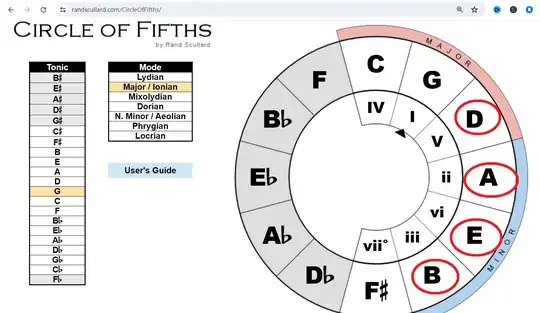

If I look visually at the circle of fifths such as via this link ; https://randscullard.com/CircleOfFifths/ and from the left column labelled "Tonic" click on the G note, I can see that the "F#" is four segments clockwise from the "G"

  • @Dan , using your example of 1.888 and 1.335, in Excel I compute as ; log((1.335/1.888)2,2)12 = 6 so here I have the same result you illustrated above, so 6 steps on the 12 step chromatic scale. So if I understand, hopefully, how to transpose as you have instructed, I take "6 fifths = 42 semitones" and in Excel I would write mod(42,12)=6. so also 6. 1.888~B# and 1.33~F, so on the wheel of fifths I should see 6 steps between B# and F. If I refer to the online circle of 5ths calculator at link italic bold and designate the "F" as the root... – AstroD Jul 02 '24 at 22:47
  • (continued from previous) it does look like there is approx 6 steps between the notes.... am I on the right track, am I understanding this correctly or am I in error in any way? – AstroD Jul 02 '24 at 22:47
