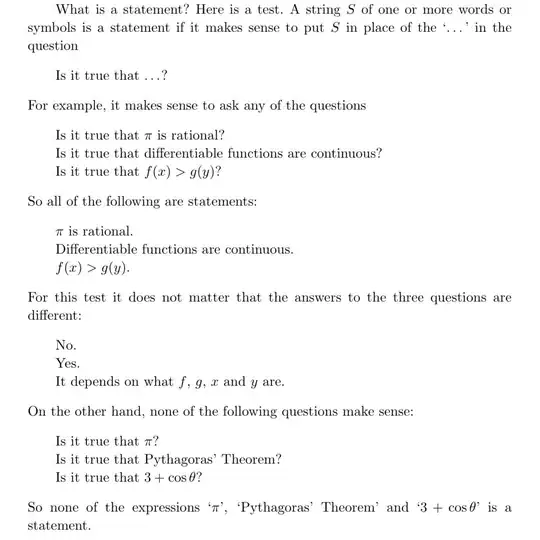

I am beginning to read Mathematical Logic by Chiswell and Hodges. In Chapter 2 Informal Natural Deduction, the authors don’t give a definition of statement. They say to use a test. I’m confused why they use f(x) > g(x) as a statement since there are free variables. They also use examples later in the chapter that have free variables. In my discrete math class a sentence that had a free variable would not be considered a statement. For example, in this book “x is prime” would be considered a statement, but x is free so I’m thinking it wouldn’t. If this is a statement how do quantifiers come into play? I thought they helped make these sentences become statements. Can someone clarify my confusion and explain what Chiswell and Hodges are doing in their book? Thank you!
I don't have that book, but it looks to me like they count something containing free variables as a statement if after assignment of some suitable values to the free variables you get a sentence that you can ask whether it is true or false. – Robert Israel Jun 30 '24 at 18:49

Don't get too hung up on the local usage, in particular books, of the likes of "statement", "sentence", "proposition".
Yes, when it comes to formal syntax, we want sharp definitions for "wff", "wff with the variable 'x' free", "closed wff" and the like. But in the pre-formal motivational chat before we get down to technicalities (and Chiswell and Hodges are here at this stage) it's enough to settle on some way of marking basic distinctions e.g. between declarative claims and questions and imperatives.
Still, you might say, isn't it odd to call e.g. '$x$ is prime' a statement? I'm not sure it would be my preferred usage, but it isn't that odd.
For example, I guess you wouldn't balk at calling Jack is tall a statement. Yet I haven't told you who Jack is. You just think Jack is tall is the sort of expression that could be used (in a context which fixes the referent of the name) to make a contentful assertion. And what about he is tall? Again, this is the sort of expression that could be used (in a context which fixes the referent of the pronoun) to make a contentful assertion. For some purposes, then, we might reasonably count them together -- and on the other side of the divide from the likes of "is Jack tall?", or "Give him the ball".
Well, likewise, it might be said in the spirit of Chiswell and Hodges, $x$ is prime is again the sort of expression that could be used (in a context which fixes the referent of the variable) to make a contentful assertion.
So maybe Jack is tall and '$x$ is prime' aren't so different after all, and at least for certain purposes can be co-classified.

I see. If we consider “x is prime” a statement in propositional logic that wouldn’t cause problems when we go to FOL? For example in this book in the chapter on FOL the authors say “x is prime” is a predicate and says $\forall x$ x is prime is a statement. But we just said x is prime is a statement. Also, in section 7.2 the authors also say “A sentence of LR(σ) is a formula of LR(σ) in which no variable has a free occurrence”. What is this meaning? Thank you! – Dr. J Jun 30 '24 at 20:44
It does look as if C+H may not be consistent in their usage here. I'd rather say that the predicate is "$\xi$ is prime" where "$\xi$" is a placeholder, whereas "$x$ is prime" is an open sentence with "$x$" a variable. But it is very common to elide the two in informal chat. – Peter Smith Jul 01 '24 at 16:24
