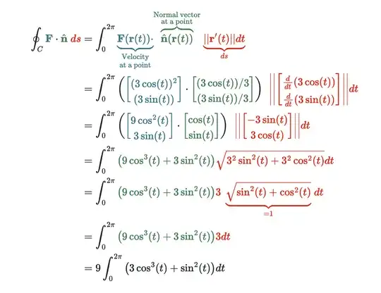

Edit: this is the method i want to use

  • The integral you are supposed to calculate does not involve $|r'(t)|,.$ It looks like you are mixing up line integrals of vector fields with those of scalar fields. – Kurt G. Jun 30 '24 at 21:17
  • @KurtG.i belieev it should, please look at the edit i have made – user832075 Jun 30 '24 at 22:16

  • Unfortunately you do not show you got $-4/3$ but I am pretty sure that you forgot to normalize your vector $\mathbf{n}$ to unit length. In my notation you should have done the (obviously unnecessary) calculation $$ \int_a^b\frac{y(t)\,\dot x(t)-x(t)\,\dot y(t)}{|\dot r(t)|}|\dot r(t)|\,dt $$ where $$ |\dot r(t)|=\sqrt{\dot x^2(t)+\dot y^2(t)}\,. $$ This integral is (in yet another notation) $$ \int_C\pmatrix{x\\y}\cdot\boldsymbol{n}\,ds\,. $$ In your case the unnormalized normal vector on that curved part of $\partial D$ is $(-2t,t)\,.$

  • thanks very much for this approahc, i like it. However, I was mainly interested in this 2nd method (see edit). Since it parallels the way to solve 3D flux integrals. – user832075 Jun 30 '24 at 22:17
  • thank you kurt g, now i undersgtand my mistakes as well. However, i believe the normalising is unecessary and i will provide and edit to my post showing my working out for this case and let you know later. – user832075 Jul 01 '24 at 09:33
