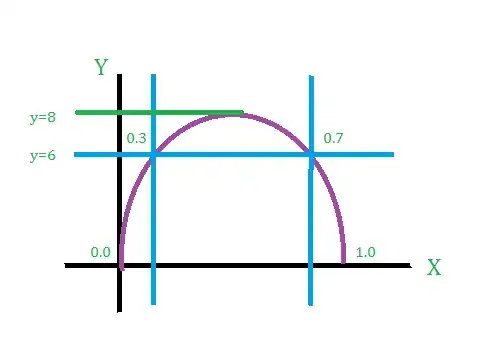

Say we want to Integrate $x+y^2$ over this Purple Curve :
Line Integral
Let us assume we are given the Curve in PBAL [ Parameterized By Arc Length ] terms. At Origin , Arc length $t=0.0$ & at right Blue Inter-Section , $t=0.7$ , which are the limits we want to Integrate over.
Now , we use change of variables & convert $s$ to $y$ & we see that the new limits are $y=0$ & $y=6$.
When we Integrate , we might unfortunately get only the Section from Origin ( $t=0$ ) to the left Blue Intersection ( $t=0.3$ ) , because $y$ was not monotonic with $t$.
In Case , we had taken the Integral from $y=0$ to $y=8$ & then added up the Integral from $y=8$ to $y=6$ ( while handling the Directions too ! ) then we would have got the right Integral value.
In Case , we had taken change of variables with monotonicity , the Integral will work out automatically.
In Summary , I agree with Eric Towers , that monotonicity is not necessary , though I do think that we have to be careful when monotonicity is not available.
