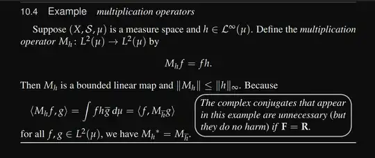

I'm trying to understand the example below, taken from Axler's Measure Integration and Real Analysis book.
How does one prove that $M_h$ is bounded and that $||M_h|| \leq || h||_{\infty}$?
I was thinking of using Holder's Inequality, $$||fh||_{1} \leq ||f||_1 || h||_{\infty}$$ However, since we're in a Hilbert space, $L^2$ has the norm given by the inner product, which is equivalent to the $||\cdot||_2$ and not $||\cdot||_1$. Also, to use something like $L^2 \subset L^1$, we need to have $\mu (X) < \infty$, which we don't in the example. Therefore, I think I'm supposed to use another inequality, but I don't see which one.
Exemple 10.4 from Axler Measure book
