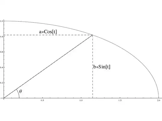

There are already a lot of good answers here, so I'm adding this one primarily to dazzle people w/ my Mathematica diagram-creating skills.
As noted previously,
$x(t)=a \cos (t)$
$y(t)=b \sin (t)$
does parametrize an ellipse, but t is not the central angle. What is the relation between t and the central angle?:
cool, huh?
Since y is bSin[t] and x is aCos[t], we have:
$\tan (\theta )=\frac{b \sin (t)}{a \cos (t)}$
or
$\tan (\theta )=\frac{b \tan (t)}{a}$
Solving for t, we have:
$t(\theta )=\tan ^{-1}\left(\frac{a \tan (\theta )}{b}\right)$
We now reparametrize using theta:
$x(\theta )=a \cos (t(\theta ))$
$y(\theta )=b \sin (t(\theta ))$
which ultimately simplifies to:
$x(\theta)=\frac{a}{\sqrt{\frac{a^2 \tan ^2(\theta )}{b^2}+1}}$
$y(\theta)=\frac{a \tan (\theta )}{\sqrt{\frac{a^2 \tan ^2(\theta )}{b^2}+1}}$
Note that, under the new parametrization, $y(\theta)/x(\theta) = tan(\theta)$ as desired.
To compute area, we need $r^2$ which is $x^2+y^2$, or:
$r(\theta )^2 = (\frac{a}{\sqrt{\frac{a^2 \tan ^2(\theta )}{b^2}+1}})^2+ (\frac{a \tan (\theta )}{\sqrt{\frac{a^2 \tan ^2(\theta )}{b^2}+1}})^2$
(note that we could take the square root to get r, but we don't really need it)
The above ultimately simplifies to:
$r(\theta)^2 = \frac{1}{\frac{\cos ^2(\theta )}{a^2}+\frac{\sin ^2(\theta )}{b^2}}$
Now, we can integrate $r^2/2$ to find the area:
$A(\theta) = (\int_0^\theta \frac{1}{\frac{\cos ^2(x )}{a^2}+\frac{\sin ^2(x )}{b^2}} \, dx)/2$
which yields:
$A(\theta) = \frac{1}{2} a b \tan ^{-1}\left(\frac{a \tan (\theta )}{b}\right)$
good for $0\leq \theta <\frac{\pi }{2}$
Interestingly, it doesn't work for $\theta =\frac{\pi }{2}$ so we can't test the obvious case without using a limit:
$\lim_{\theta \to \frac{\pi }{2}} \, \frac{1}{2} a b \tan ^{-1}\left(\frac{a \tan (\theta )}{b}\right)$
which gives us $a*b*Pi/4$ as expected.
