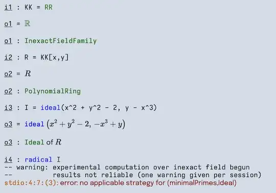

I'm trying to learn how to compute the radical of polynomial ideals in multiple variables over the real numbers in Macaulay2. From what I've gathered in some stack exchange posts([1], [2]), I just need to define a polynomial ring and run the radical command. Now when I do it, I get the following:
Here, I'm trying the basic example of $I = (x^2 + y^2 - 2, y - x^3) \subset \mathbb{R}[x,y]$.
From what I gathered from what I gathered from this answer as well as from the documentation is that there are general algorithms to compute radicals of polynomial ideals - even if they can get slow with increasing numeric complexity in the generators - and that as long as the ground field is characteristic 0, we can do so in Macaulay2. My questions are:
  1. Are there any mistakes in my code? If not, am I misunderstanding something about the algorithm / theory around this?
  2. More generally, if one has a groebner basis of an ideal, is there a general algorithm for computing the generators of the radical? I know classifying such a basis in general is a difficult question.
EDIT: 3. I should note that I did see this post which claims that one can only generate a subset of the generating set (in general). I'm not quite sure how that connects to the other linked posts which state that there are algorithms which are slow.

So, repeating your calculation with the exact KK = QQ instead of the inexact KK = RR gives the desired result:
i4 : radical I
o4 = ideal(x^2+y^2-2, xy^2-2x+y)
o4 : Ideal of R
i5 : (radical I) == I
o5 = true
