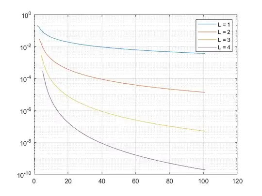

8
We have $$\frac{(n-k)^{n-k}}{n^n} = n^{-k}\left(1-\frac{k}{n}\right)^{n-k} \approx n^{-k} e^{-k}$$
As you can see, the magnitude $(n-k)^{n-k}$ decreases extremely fast, and the vast majority terms in the sum are just going to be indiscernible. So you can modify the sum in this way
$$ \begin{align} c_t/\beta &= \sum_{k= 0}^{L}(b-k)^{b-k} + \sum_{k= L+1}^{a}(b-k)^{b-k}\\ &\approx \sum_{k= 0}^{L}(b-k)^{b-k} + \sum_{k= 0}^{a-L-1}(b-L-1)^{b-L-1-k}e^{-k}\\ &\approx \sum_{k= 0}^{L}(b-k)^{b-k} + \frac{e(b-L-1)^{b-L}}{e(b-L-1)-1}\\ \end{align} $$
when $a > L$, where $L$ is a cut-off limit that depends on how big $b$ is. Usually $L = \frac{\text{desired bit precision}}{n \log_2 n}$.If you are not very keen on precision then $$\sum_{k= 0}^{L}(b-k)^{b-k}$$ is enough for $a > L$
EDIT
FYI here's a relative error graph for the simple cut-off method enter image description here
