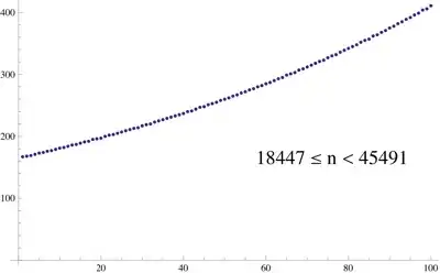

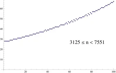

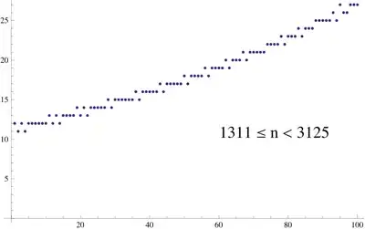

On $I_{10}$, the counts in each interval of size $0.01$ are
On $I_{11}$, the counts in each interval of size $0.01$ are
On $I_{12}$, the counts in each interval of size $0.01$ are

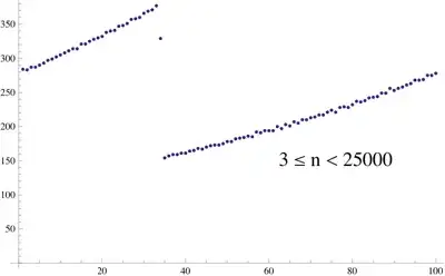

So as described above, on each $I_n$, the density is $\frac{e^x}{e-1}$. However, since the counts on $I_{n+1}$ are approximately $e$ times the counts on $I_n$, the picture is different if we don't consider complete intervals $I_n$:
The jump has a ratio of about $e\left(1-\frac1{\log(n)}\right)$ since $\{\log(\log(n!))\}$ cycles through $[0,1]$ as $n$ goes to $ne\left(1-\frac1{\log(n)}\right)$, as mentioned above.
