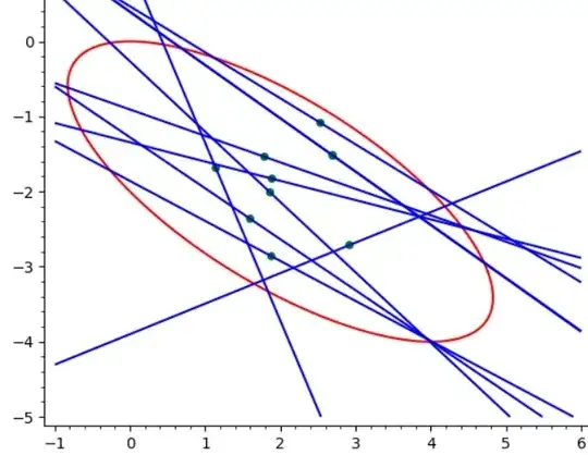

Here is a graphical representation in the case of an ellipse :
*Fig. 1.$

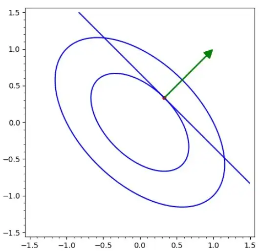

Edit : I answer your question about the fact that the normal vector to the chord is "rather surprisingly"
$$QX_1+V$$
i.e., equal (up to a $2$ factor) to the gradient of expression (6) computed in point $X_1$.
Have a look at figure 2 featuring a conic curve, and a point $X_1$ which is the midpoint of a chord found by the $T=S_1$ method
Fig. 2. Homothetic curves $Q(x,y)=1$ and $Q(x,y)=1/3$ with $Q(x,y)=x^2+xy+y^2$ and $(x_1,y_1)=(1/3,1/3)$.
This chord is in fact tangent to a homothetical ellipse to the initial ellipse : no surprize that the gradient at point $X_1$ is orthogonal to the tangent to the curve.
